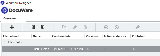

I have one workflow created as a test by one user, that user has been deleted from the system, how can I delete that workflow.
I'm the organization admin, but I don't have the right to do anything with that specific workflow from Workflow Designer.
Please see attached screenshot

In this case, it is not possible to access/delete the workflow anymore. Doing this via the database can be tricky because of dependencies so instead it is good practice to add another user as designer, this user can then delete the workflow in the Workflow Designer as usual.
