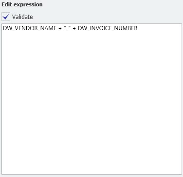

Compare with this: DW_VENDOR_NAME + "_" + DW_INVOICE_NUMBER
When this customer has to view, download, or send this file cabinet document as an email attachment it has a useful filename.

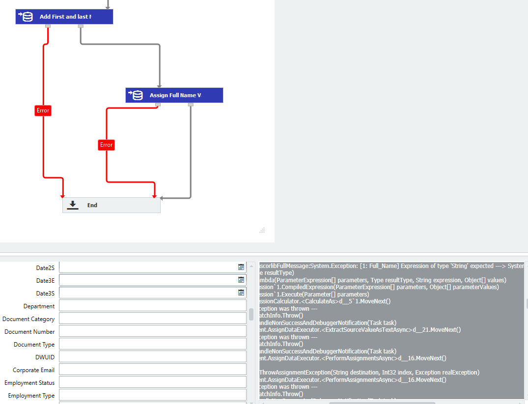

Hi Mathew.  This is what I have and I get an error about Expression of type 'String' expected.
This is what I have in the Arithmetic Expression.  I also set to Validate.
GV_Full__Name =DW_FIRST_NAME + “ “ + DW_LAST_NAME
The screen shot shows part of the error when running a test on Workflow manager.   I am thinking I am missing something to make this a string.

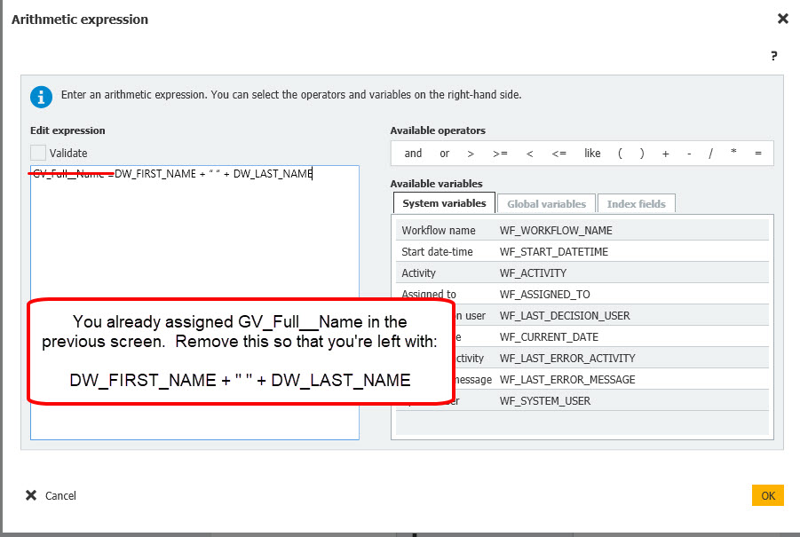

Posted Fri, 14 Jun 2019 22:19:32 GMT by Matthew Trembly Software Support Manager
You're already assigning GV_Full__Name in the data assignment prompt.  Check out my attached revision.

Thanks Matt.  Yep this is what I saw in your last screen shot and made the change to my workflow.  I was trying to think of it as a calculation not as setting data to a variable that I was already in.  In other words, what I was doing, was causing the background script to be GV_Full__Name =GV_Full__Name =DW_FIRST_NAME + “ “ + DW_LAST_NAME if you were looking and the SQL statement.
