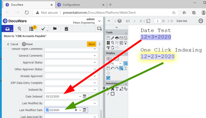

See attached image. One Click Indexing is switching the month and day incorrectly. This has been tested with multiple 7.3 systems, Cloud and On-Premise, with the same bad result
For example:
12-23-2020 will read and index correctly as 12-23-2020
12-2-2020 will incorrectly be stored as 2-12-2020

I noticed this too with a date in May when using the One Click Indexing on a email.
5/3/2020 (May 3, 2020) was captured incorrectly as March 5, 2020
