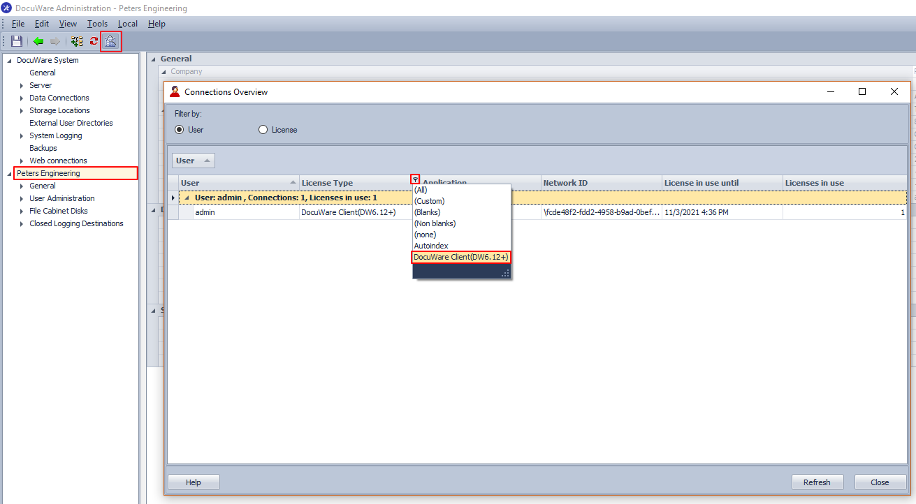

Hi Angel,
yes, you can see the currently logged in users in the "Connections Overview" in the DocuWare Administration:
  • Log in to DocuWare Administration as administrator
  • Select the organization on the left
  • Then in the top menu open "Tools" > "Connection Overview" or click the appropriate button
  • In the Connections Overview all connections to the DocuWare system are listed
  • To find out how many users are currently logged in, filter for "License Type" = "DocuWare Client (...)"
I've also attached a screenshot.
