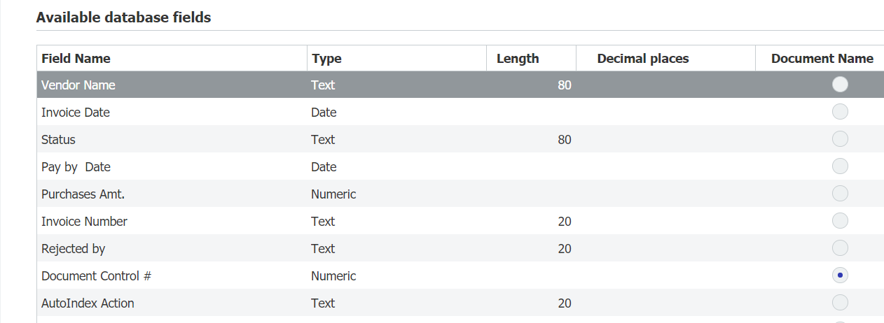

After upgrading to v7.3 a user has noticed/complained, that the value displayed at the top of the viewer pane is no longer correct. It was the field marked as the document name in the database fields of the file cabinet configuration. It now seems to be the document name from the document tray.
Is there a way to control this displayed value?
See image...

Publié Wed, 23 Sep 2020 14:09:09 GMT par Steve Shriver Application Specialist
More on this -
It appears that from the Document Tray the Name of the document in the tray is used.
From the file cabinet the name of the image file itself is used. So in my case "Scan Inbox - 001". Which is useless.
I renamed it in the tray before storing, and then that name was used in both cases.
In any case, the field designated as the 'Document Name' in the database fields configuration is NOT used. Which, I believe, would be much better, allowing us to control it.
Has this been changed in v7.3 purposefully? Can it be modified?

Publié Mon, 28 Sep 2020 13:30:11 GMT par Steve Shriver Application Specialist
My build is 7.0.3.55801. In every case it seems to be the file name.
See the images for examples

Publié Fri, 04 Feb 2022 14:43:36 GMT par Steve Shriver Application Specialist
Last night I applied the latest minor update for v7.3 DW7.3_2022-02-01 (Build 7.3.0.56240) on premises.
Documents stored before this update as well as documents stored recently both display the file name (bottom left of the viewer pane) at the top of the viewer pane. I would like to see the field designated as the Document Name in the Database Fields section of the File Cabinet configuration.
Is this possible? As mentioned previously in this post, that was what we were used to in our previous version (6.12).
Is there any way to control what is displayed in this area?
