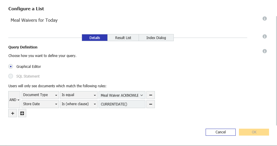

Publié Tue, 04 Jun 2019 21:09:26 GMT par Michael Weingand Professional Services Manager
HI Phil,
This is what I have done and it does not work.  See screen shot.  When I exclude the Store Date, I do get a results list with all docs, as I would expect but when I add the Store Date "Is Where" CURRENTDATE() I get nothing.  Any advice?
Publié Wed, 12 Jun 2019 21:24:44 GMT par Matthew Trembly Software Support Manager
Phil's config will work for 7.1, but for anything 7.0 and previous, you'll need:
Store Date "Is (where clause)" >CURRENTDATE()
Because I believe DW system Store Date used to evaluate current date as datetime, so current date was always newer than store date even if was the same day.
It changes for the better in 7.1!
