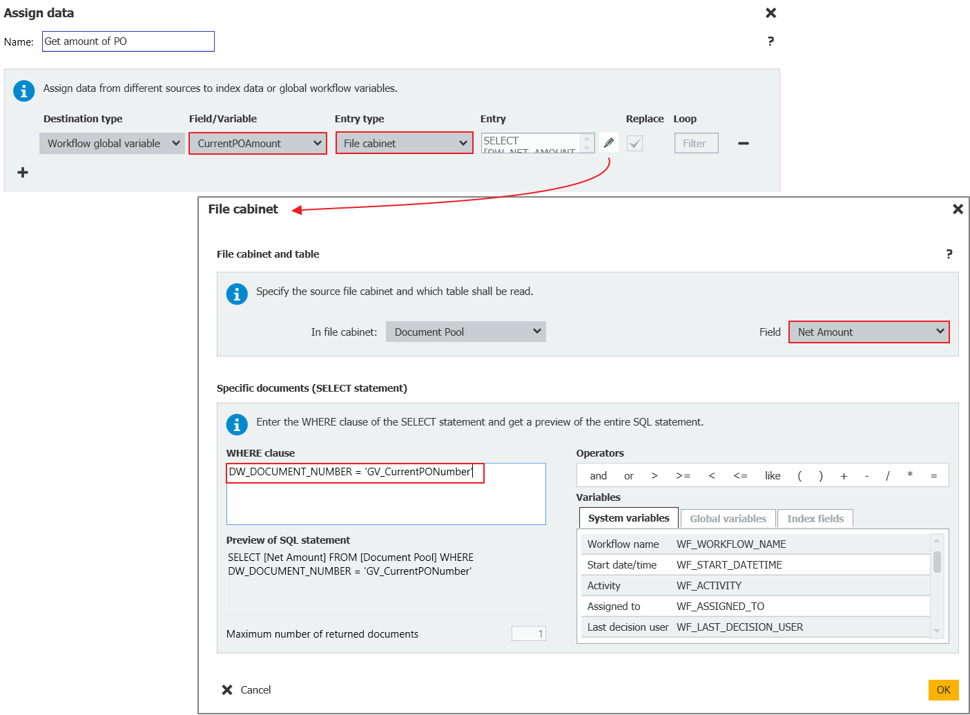

Thank you, Gerardo, for this explanation.&#160; It has been very helpful but I have one question.<br> <br> In step 5, you say to &quot;Get the amount of the appropriate PO by querying the document&quot;.&#160; Would you please explain the syntax needed to query the CurrentPONumber to copy the CurrentPOAmount.&#160;&#160;
Publié Fri, 10 Mar 2023 08:56:31 GMT par Gerardo Lisanti Team Leader Product Management
Hi Randy,<br> <br> You are welcome. I have attached a screenshot showing how this could be done.<br> The WHERE is simple SQL, you can query the document in the file cabinet by searching for the &quot;<code>document number</code>&quot; with the global variable &quot;<code>CurrentPONumber</code>&quot;, e.g.&#160;<code>DW_DOCUMENT_NUMBER = 'GV_CurrentPONumber'</code>&#160;&#160;and take over the &quot;<code>(Net) Amount</code>&quot; to &quot;<code>CurrentPOAmount</code>&quot;<br> <br> Viele Grüße / With best regards,<br> <br> --<br> <br> Gerardo Lisanti<br> Product Manager &#160;| &#160;DocuWare GmbH

Gerardo,<br> <br> That worked perfectly.&#160; Thank you!<br> <br> Randy
