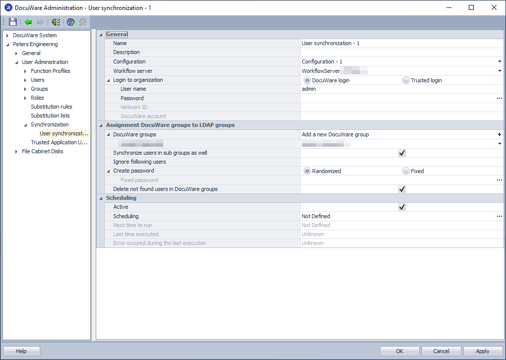

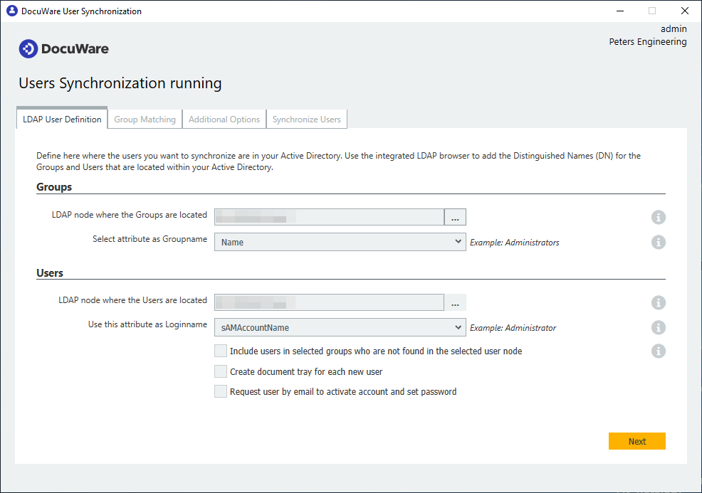

Which User Synchronization are you using? The integrated one in DocuWare Administration, referred to as User Sync V1, or the standalone Desktop App, referred to as V2. See screenshots below:

Publié Wed, 09 Mar 2022 18:26:08 GMT par Jon Weston File IT Solutions Sr Application Developer and RIM specialist
Hi Thomas, we're using User Sync v1.  We're finding that DW will not move the user to the new group if they're an already-existing user in DW - are you saying that we should be able to configure it so that DW will actually move them to the new group? Or does V2 have that capability?
