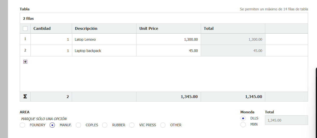

Any solutions to this?  I'm seeing that I don't even have an option to add a table to a merge form.
Registrato Wed, 09 Apr 2025 21:14:19 GMT di Juan Cassis TGI Office Automation Systems Engineer
I am dealing with the same issue! If data from a Table field in a form is not able to merge the data to a merge form...then remove the table option from the Form Designer Fields list when an user is using a merge form....

Registrato Sat, 17 May 2025 14:42:34 GMT di Javier Sanchez IT Support
Hello
At the moment it is not possible to apply directly the values of a table in the area mapping of the merge form, but you can do it through the workflow.
You should enable the form to be editable in the merge form configuration, create the fill areas but without assignment and in the workflow assign the values of the table to the fill areas of the form.
