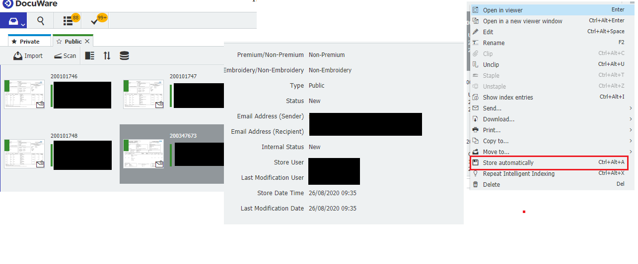

It seems we have 2 document trays. Users are using the outlook app to set the indexing values in outlook, which then sends the emails into 1 of the 2 trays in Docuware, with this indexing information coming through with it. The users complaint is that they then have to access the web app and click 'store' on all these imports.
I noticed their is a 'store automatically' option in the rightclick menu, if the users select all the emails in the Docuware tray and used this would it store using the indexing values the items have against them from the outlook app selection? If so, is there a way to automate this so the users do not have to login to the webapp and manually initiate this?
I have attached a few screen snaps to hopefully help illustrate.

Your users could use the "Store Automatically" functionality in the tray but I would suggest that you switch over to the DocuWare Configuration (Click on your name at the top and choose "Configurations"), then open "Outlook Email" from the configurators. You should check which configuration your users are using (In Outlook click on the tab "DocuWare" and check the dropdown for Storage). Back in the configuration open this configuration and change the target to be directly the file cabinet.
Back in Outlook log out from DocuWare and back in (or restart Outlook) and give it a try.

The import tray is set for Intelligent Indexing (II) and as such, will attempt to fill index fields as it tries to find the right information.  II is set up by tray and is used to find and index fields from unstructured documents (heavily used for AP Invoice capturing).
Craig, is II populating additional fields above what the users are populating?  If so, storing directly to the cabinet from Outlook will bypass the fields indexed by Intelligent Indexing.
投稿済み Thu, 03 Sep 2020 11:45:13 GMT 、投稿者 Craig Taylor Applications Analyst
Thanks for your reply Marie, we have attempted to use the direct to file cabinet option but as you say, it seems to be missing the intelligent indexing sections - the Customer and Purchase Order number fields in this case.
Is there a way to have these picked up with the direct to cabinet option?
投稿済み Thu, 17 Sep 2020 12:56:24 GMT 、投稿者 Craig Heintz SE
There is not a way for theses fields to be pickup up automatically and then stored to the tray unless they are in the same zone all the time and an OCR template can extract them.  But usually these are A/P invoices from avariety of vendors so the info moves around.  In that case you need Intelligent Indexing which can only be done in a tray and therefore not automated to the cabinet directly
