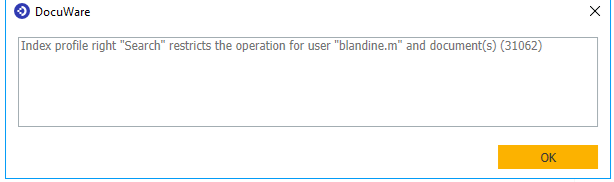

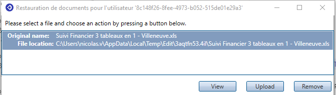

-    In picture 1,  you can see the title of the message that is in French (it means “Restauration of document by the user ‘8c148f26-xxxxx…’ ”, while the other part is in English
-    In picture 2, you could read the content of the message that is in English “Index profile right “Search” restricts the operation for user “Blandine.m” and document(s) (31062) ”, this one appears when the user is stocking a document in an operation, at the end, he has this message (because he has restrictions and that is normal, just the English part is not expected)

Hi Daniel,
this is not exclusive to French and even happens in German.
I think all the exclusively English messages I have seen are rare error messages, nothing important or noteworthy for the day-to-day user.
The reason why this happens is probably because these Texts are hardcoded instead of using resources, most likely a bit of "sloppy" programming from years past.
You might want to open a support request with the details about every message of this kind you can find - if support passes it on to the developers, it might get fixed in the next version.
