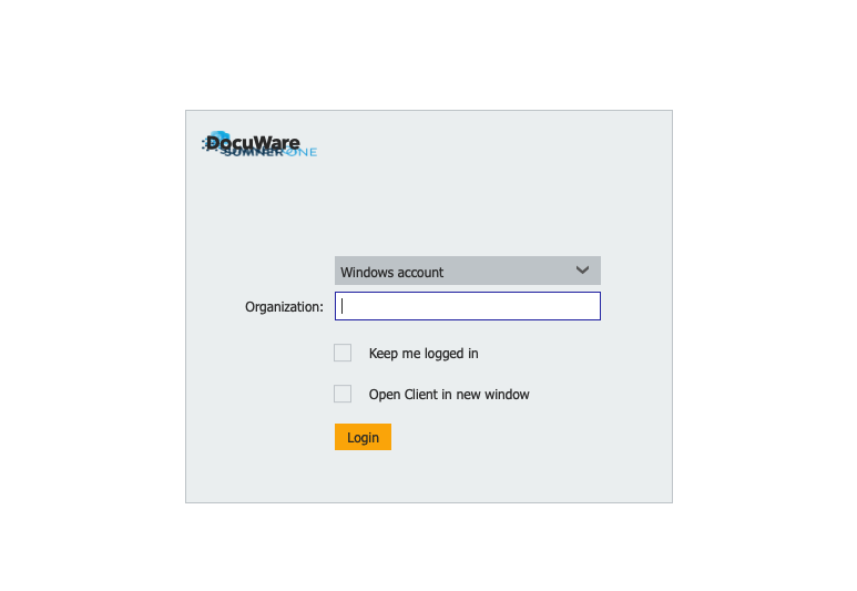

I have updated the logo for our login page and top left logo on the web client. This has always worked fine. But now it shows the logo and also the docuware default logo overlayed. What am I missing? This is docuware version 7
投稿済み Fri, 29 Mar 2019 16:14:03 GMT 、投稿者 Casey Miller Director of Technical Services
Here is a screenshot of what it looks like
投稿済み Sat, 30 Mar 2019 14:11:27 GMT 、投稿者 Craig Heintz SE
Try this Custom.CSS
I use two different resolution logo's one for the login page and one for the Web Client home.
logo10 is the login page, logo20 is the web client.
投稿済み Mon, 01 Apr 2019 19:00:01 GMT 、投稿者 Casey Miller Director of Technical Services
Thank you, Craig. This worked.
