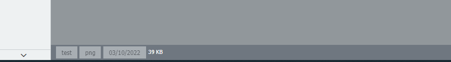

投稿済み Wed, 28 Feb 2024 09:16:23 GMT 、投稿者 Mélanie Mélanie
Thanks for your help. Indeed, I have made the same thing as you did. It modifies the index as well as the file name when the file is downloaded. But it does not modify the file name which appears in the file viewer. Did you manage this ?
