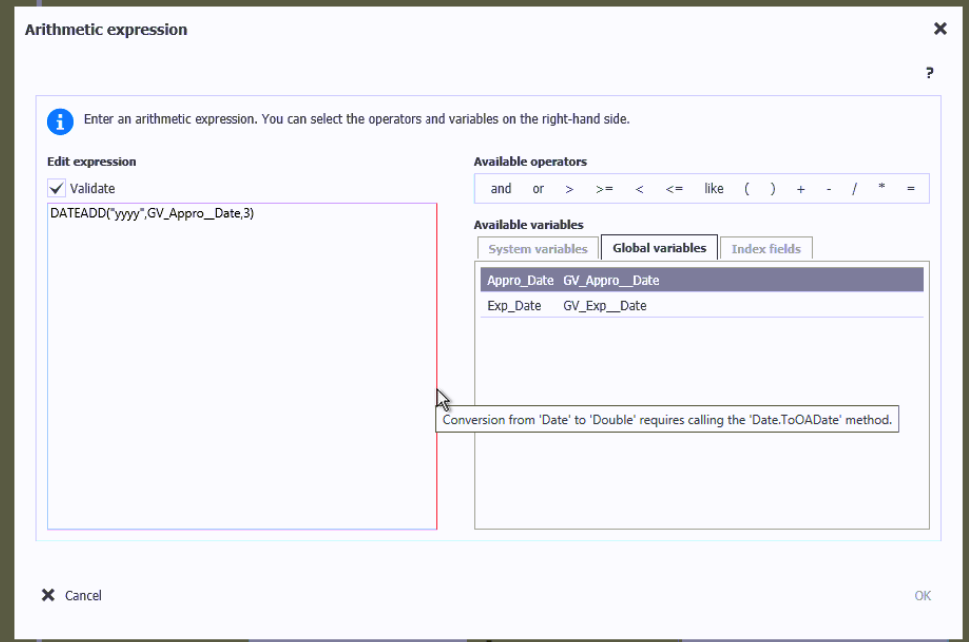

Veröffentlicht Fri, 22 Mar 2019 15:16:25 GMT von Casey Miller Solutions Manager
Phil, i have tried this but it isn't validating. This is the error it is giving me. See attached.
Veröffentlicht Fri, 22 Mar 2019 15:29:06 GMT von Phil Robson DocuWare Corporation Senior Director Professional Services, Americas
Well that's plain unfair, because I reversed the criteria. Oops.
Try this:  DATEADD("yyyy",3,GV_APPRO_DATE)
