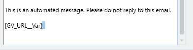

Veröffentlicht Tue, 08 Oct 2019 15:33:19 GMT von Edwin Fabian Donato TI
What type of variable should I add?
attached evidence of what happens now
Veröffentlicht Tue, 08 Oct 2019 15:52:00 GMT von Phil Robson DocuWare Corporation Senior Director Professional Services, Americas
First of all, your variable should be a text variable. Next, when you assign a fixed entry in DocuWare you do not enclose the fixed entry in quotes.
You only use quotes when you assign a text value in an arithmetic expression.
Your first link is not formatted correctly. Use the same link text as your second link.. Trying to change the internal workflow won't work.
Do this -
Link to Form:
[MYVARIABLE]
