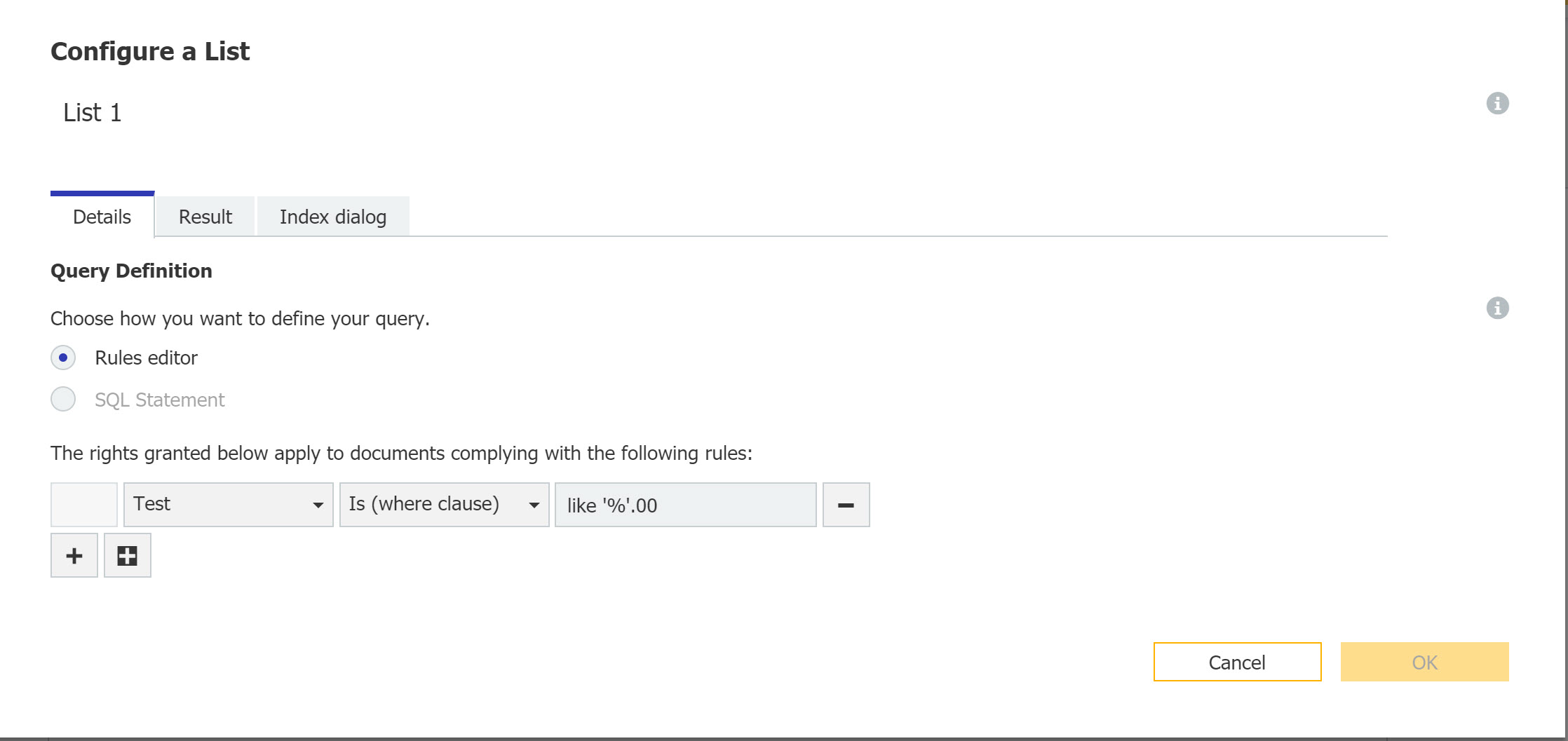

I am trying to use a list to return only the documents that end in .00 in the text field with the following where clause like '%'.00, but i am not getting any results.
Posted Mon, 09 Sep 2019 14:52:15 GMT by Tim Ohm
The "is (where)" in the 2nd column is actually your "like" qualifier.  So I think just include the value you want in the last column "*.00" should do it.  Not sure if you would need quotes around it - whatever you would use in a search dialog can go in the list definition.
You would only use "%" if using an actual SQL statement.
