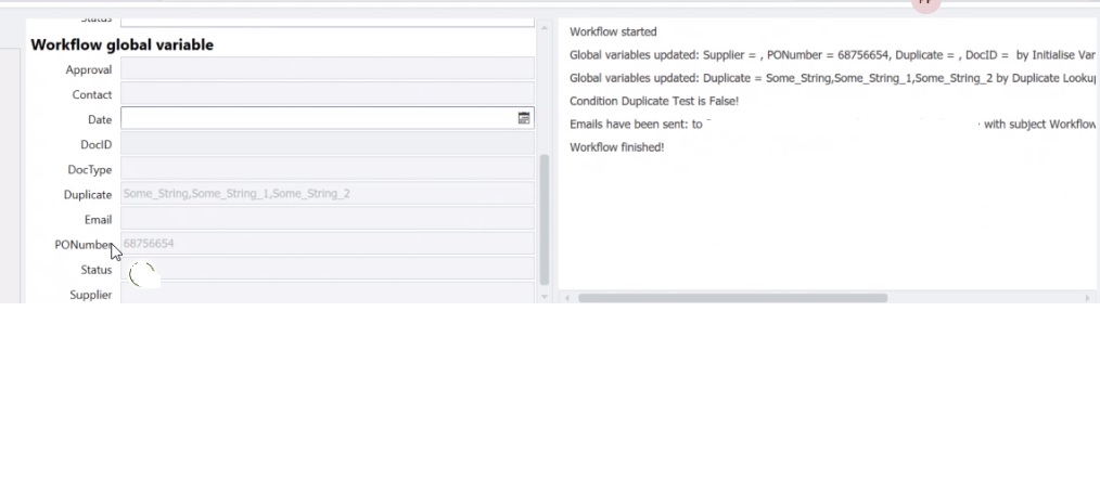

I've set up a check for duplicates work flow using the knowledge base KBA-36363
But when we test the workflow it states some_string,Some_String_1,Some_String_2 ( see pic attached) no matter if its a duplicate PONumber or not. So i cant get it to say its not a duplicate.

the test function in the workflow designer does not work.
You have to publish your workflow and test it in the web client.

Thanks. Yes it was just that the test doesn't work.
