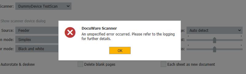

Each attempt throws an error stating:
DocuWare Scanner
An unspecified error occurred. Please refer to the logging for further details.
Using the log viewer doesn't really help in determining what has occurred.

I ran the LogCollector and examined the logs.
I finally found, in the DocuWare.Desktop.CaptureService.Host log, the following error:
"Could not convert C:\Scanner\TestScan\.... - Copy.bmp to BMP file. Reason: Out of memory.....
To resolve it, I cleared the existing files, opened a new jpg and saved it as a brand new bmp.
It eliminated the error and I was able to successfully 'scan' new images.
