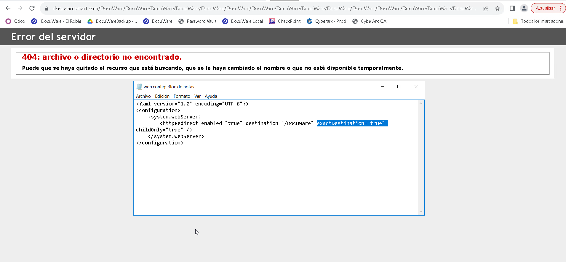

Posted Wed, 25 Oct 2023 15:45:05 GMT by Carlos Francisco Chavarría Rustrián JEFE DE INFORMATICA
Hello, I have tried the recommended configuration, however, it did not work.
If I enter
https://docuwaresmart.com/ it redirects me to https://docuwaresmart.com/DocuWare/DocuWare/DocuWare/DocuWare/DocuWare/DocuWare/DocuWare/DocuWare/DocuWare/DocuWare/DocuWare/DocuWare/DocuWare/DocuWare/DocuWare/DocuWare/DocuWare/DocuWare/
and if I enter https://docuwaresmart.com/12345 it takes me to https://docuwaresmart.com/DocuWare/DocuWare/DocuWare/DocuWare/DocuWare/DocuWare/DocuWare/DocuWare/DocuWare/DocuWare/DocuWare/DocuWare/DocuWare/DocuWare/DocuWare/DocuWare/DocuWare/DocuWare/
as recommended in the beginning I am adding the code to a web.config in the path C:\inetpubwwwroot

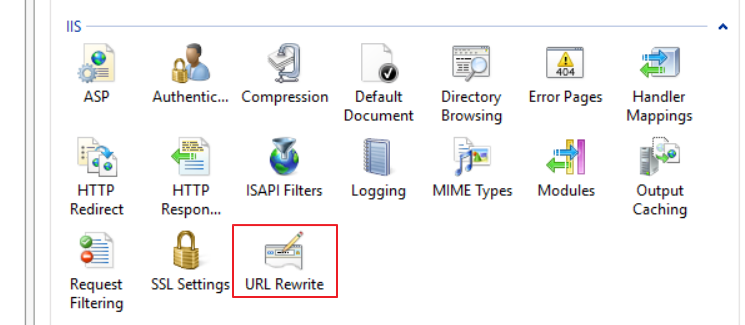

Posted Thu, 26 Oct 2023 07:27:39 GMT by Gerardo Lisanti Team Leader Product Management
Hi Carlos,
I have found that what you want is not possible with the Redirect module. You need to use the URL rewrite module in IIS.
If it is not available, you have to first download and install it from here: https://www.iis.net/downloads/microsoft/url-rewrite
Afterwards, use this code in your wwwroot web.config to redirect the requests:
<?xml version="1.0" encoding="UTF-8"?>
<configuration>
    <system.webServer>
        <rewrite>
            <rules>
                <rule name="Redirect to DocuWare" stopProcessing="true">
                    <match url="^DocuWare$|^DocuWare/(.*)$" negate="true" />
                    <action type="Redirect" url="/DocuWare" />
                </rule>
            </rules>
        </rewrite>
    </system.webServer>
</configuration>
It uses the regular expression ^DocuWare$|^DocuWare/(.*)$ to check the URL.
All requests that do not match this expression will be redirected to /DocuWare
