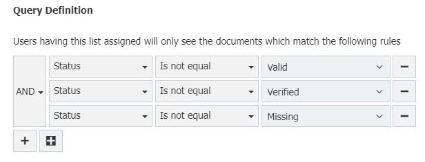

I'm trying to filter out the values in my List Dialog.
I've set a value using the drop down selection "not equal" and enter the value I don't want to see in my List. However those documents still show up.
I have no other values, so nothing is supperseeding this filter. I've also tried with the is Where clause, and saying NOT 'Missing'
So basically it seems the List Dialog is now ignoring my filters. This is a new customer config, on Docuware cloud version 10.
I only want to filter out the Status values, "Verified" or "Missing"
Thank-you in advanced.
Posted Wed, 12 Jun 2024 18:25:19 GMT by Thomas Stephens
well. I just figured out what was wrong, I was using Logic, to say "not equal" using the OR option. and I should have been using the AND option with my filter.
Seems 2 Negatives don't make a positive after all.
