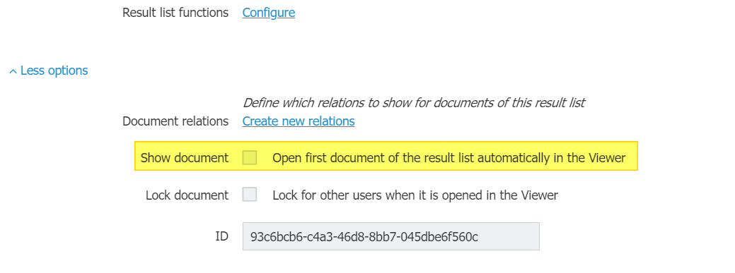

Posted Tue, 26 Oct 2021 14:34:10 GMT by Gerardo Lisanti Team Leader Product Management
Hi Sebastian,
maybe the result list you are opening has the option enabled to automatically open the first document in the viewer?
You can find the option in the settings of the result list in the file cabinet administration, under "More options" (see screenshot)
Show document:  Open first document of the result list automatically in the Viewer
Manager Product
Posted Tue, 26 Oct 2021 16:13:57 GMT by Sebastian Schultz Regional Sales & Consultancy Manager - Indirect Sales Division
Yes that was the problem. :)
