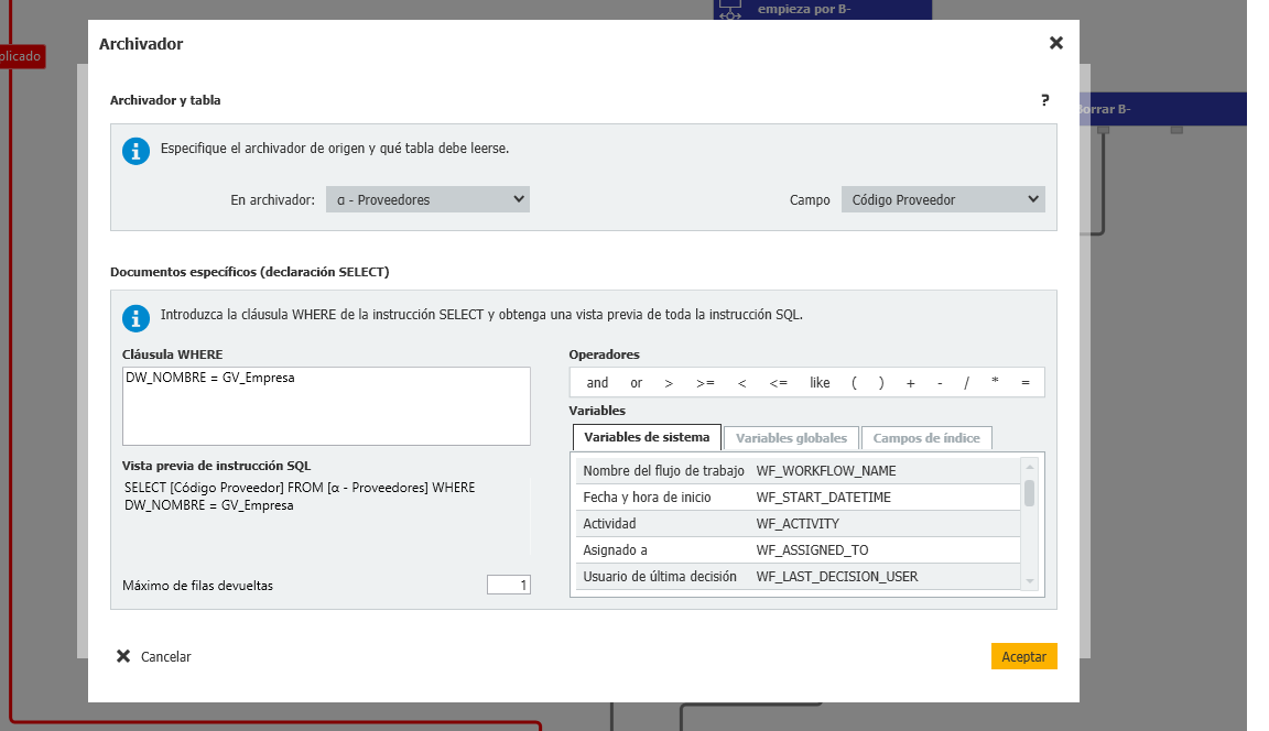

I'm trying to get the supplier code ( from a FC that is not asigned to this Workflow ) using the following method (see attched file).
I get nothing out of that, it doesn't return anything, like it's not comparing the GV and the index field. I've double-checked and the GV and the index field have the same value.
Thanks in advance

The field DW_NOMBRE is probably a text field. Therefore, its value should be enclosed in single quotation marks, like this:
DW_NOMBRE = 'GV_Empresa'

Instead of using "=" it would fit better using "like", sometimes the name isn't equal to the data in our database,  I've seen that you have to use "&" and "%". I've tried but I don't get anything but an error.

you have to provide the SQL WHERE clause in SQL Syntax.
So the correct syntax for a query using the LIKE operator is:
DW_NOMBRE LIKE '%GV_Empresa%'
See also: LIKE (Transact-SQL) - SQL Server | Microsoft Learn
