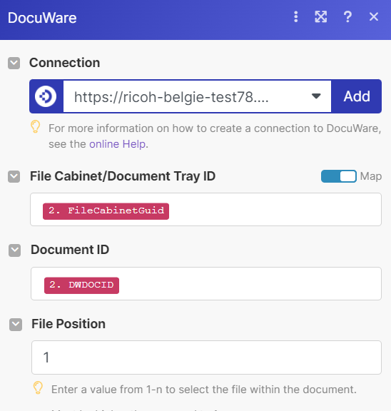

Mayra<br> <br> this is possible when using a make.com scenario (see attached screenshot)<br> <br> use a webhook based on a 'new document' event on a given file cabinet<br> make sure you have the docid of the document as a parameter (json configuration of the webhook in docuware)<br> <br> In the scenario add Docuware module - Delete File, enter the parameters from the webhook module<br> <br> filecabinetguid &amp; docid<br> <br> and enter 1 in File position (to delete the first and only file (pdf form date) of the document)<br> <br> that's it<br> <br> please see attached files for more context<br> <br> <br> <br> &#160;
