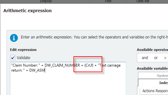

Registrato Thu, 07 Nov 2019 15:48:56 GMT di Brian Osborn Applications Systems Analyst
I am trying to add a carriage return line feed control CrLf within an arithmetic expression.  It validates the syntax, but the desired output is not happening.   Any pointers would be greatly appreciated.  The control characters are discussed on page 4 of the Workfow Expression Parser document.

Registrato Thu, 07 Nov 2019 17:58:47 GMT di Brian Osborn Applications Systems Analyst
Hi Phil, I am actually using the 'Description' designation within the task which appears to have no trouble displaying wrapped lines of text.

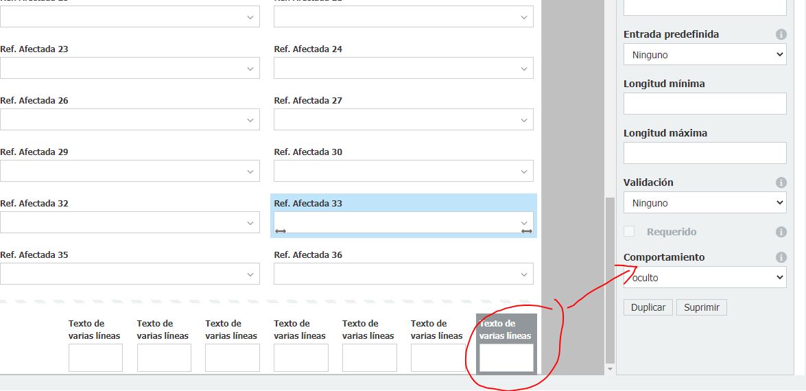

Registrato Fri, 10 Jun 2022 14:17:58 GMT di Jorge Moreno IT Administrator
se puede hacer si en el formulario web creamos un control del tipo texto de varias lineas (no es necesario indexarlo con un campo de la BDD, yo los oculto y listo) y lo asociamos al area de relleno que recibira la expresión aritmetica con el retorno de carro concatenado FUNCIONA !!!<br> <br> SALUDOS<br> <br> &nbsp;
