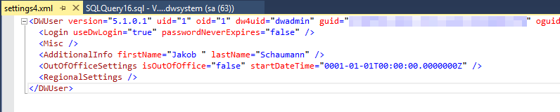

投稿済み Tue, 15 Feb 2022 11:14:40 GMT 、投稿者 Jakob Schaumann Senior Specialist Software Support Team RED EMEA
Dear Mr Bertossa,<br> <br> thank you for your question.<br> <br> In the DWUser table you can find the coloumn "settings" in this XML the first and last name is saved under additional information. I have attached a screenshot.<br> <br> With best regards<br> <br> <span style="font-size:11pt"><span style="font-family:Calibri,sans-serif"><b><span style="font-size:10.0pt"><span style="font-family:&quot;Arial&quot;,sans-serif"><span style="color:#ff9d00">Jakob Schaumann</span></span></span></b></span></span><br> <span style="font-size:11pt"><span style="font-family:Calibri,sans-serif"><span lang="EN-GB" style="font-size:10.0pt"><span style="font-family:&quot;Arial&quot;,sans-serif"><span style="color:#767171">Software Support Team ORANGE EMEA</span></span></span></span></span><br> <br> <br> &nbsp;
