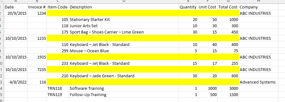

I'm trying to create a custom content layout report, invoice with line item details, to be accepted by customer's ERP system.
Objective is to have each line item, which is from the table, displayed in each row. Common indexes like Date, Invoice# and Company should appear once only for each document.
Please refer to the attached sample report. Almost managed to achieve it, it just that the 1st line item indexes cannot align together with the common indexes.
Any advise to  move the line items 1 row up, to be aligned with the common indexes? Thank you.

Hi Winston Ong,
your specific requirement is currently not possible. The only possibility would be to repeat the common indexes in every line of the table data.
