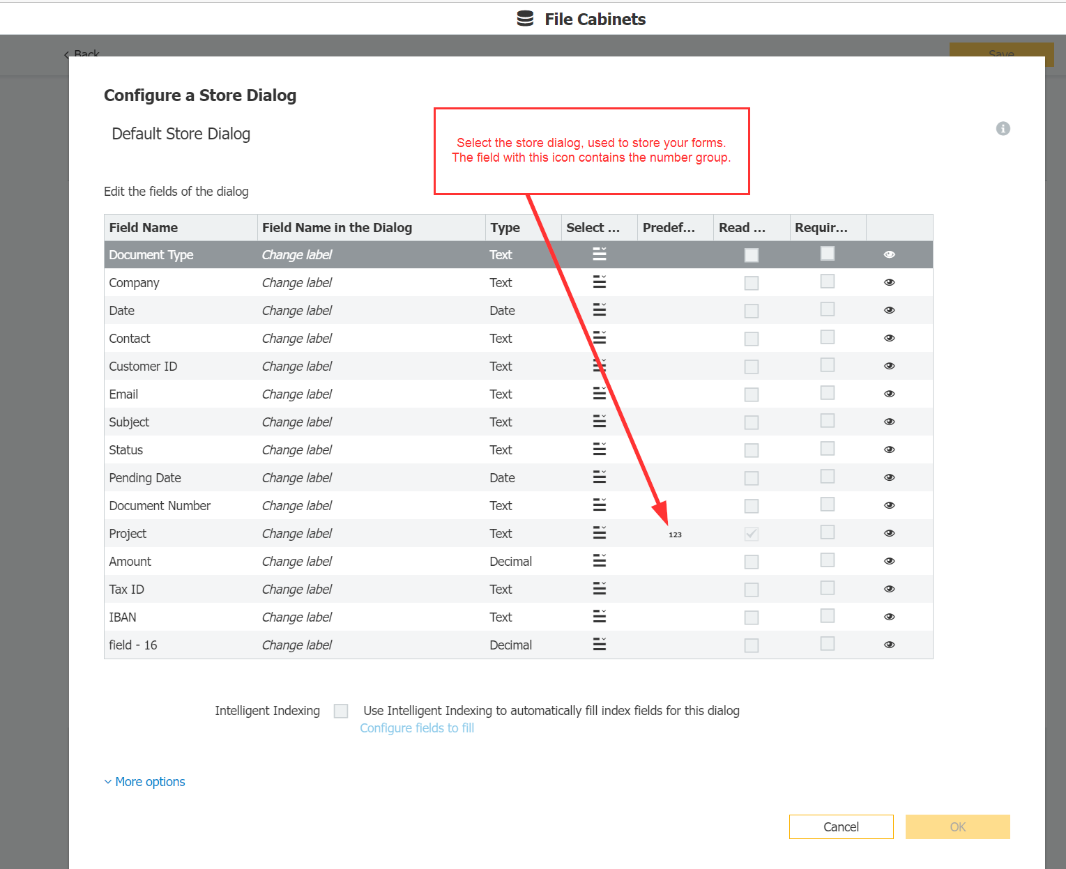

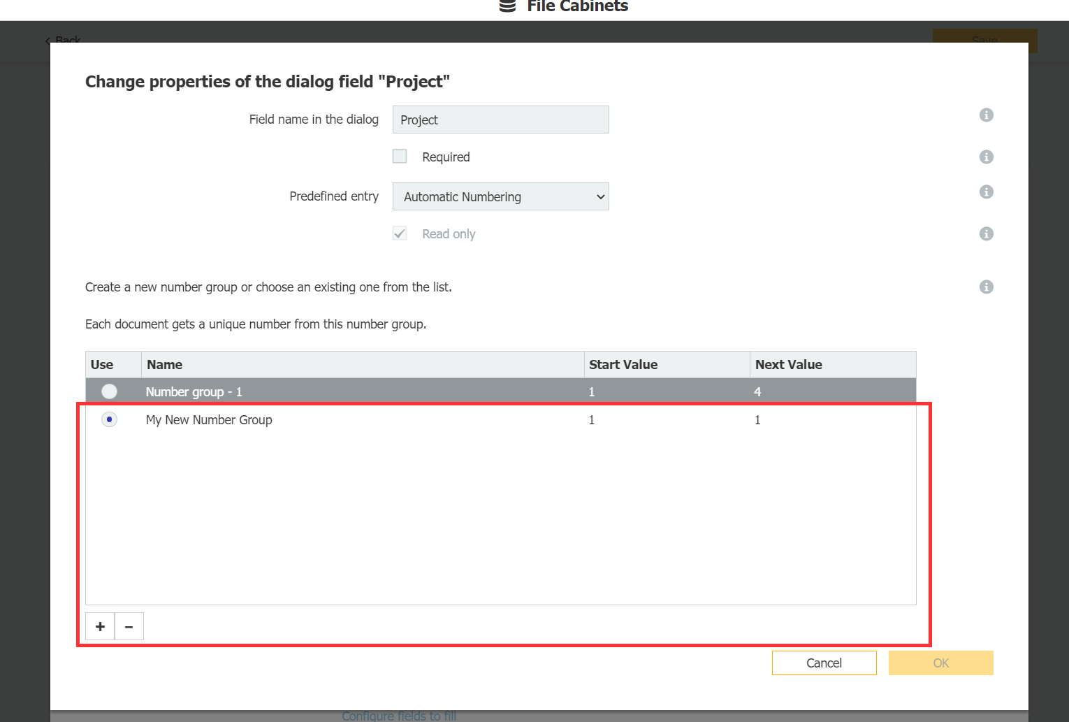

Dear Koffi Roméo Koffi,
you can not directly reset an automatic number, but you can define a new number group.
Here is a description: https://support.docuware.com/fr-FR/knowledgebase/article/KBA-36093
This new Number Group can then be selected in the DocuWare Forms configuration.
