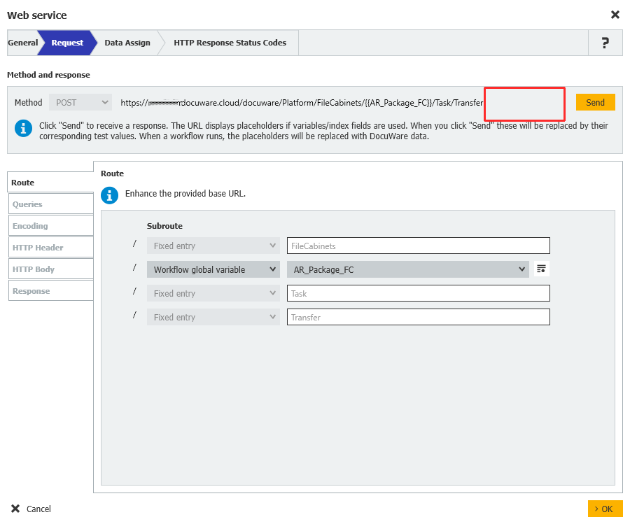

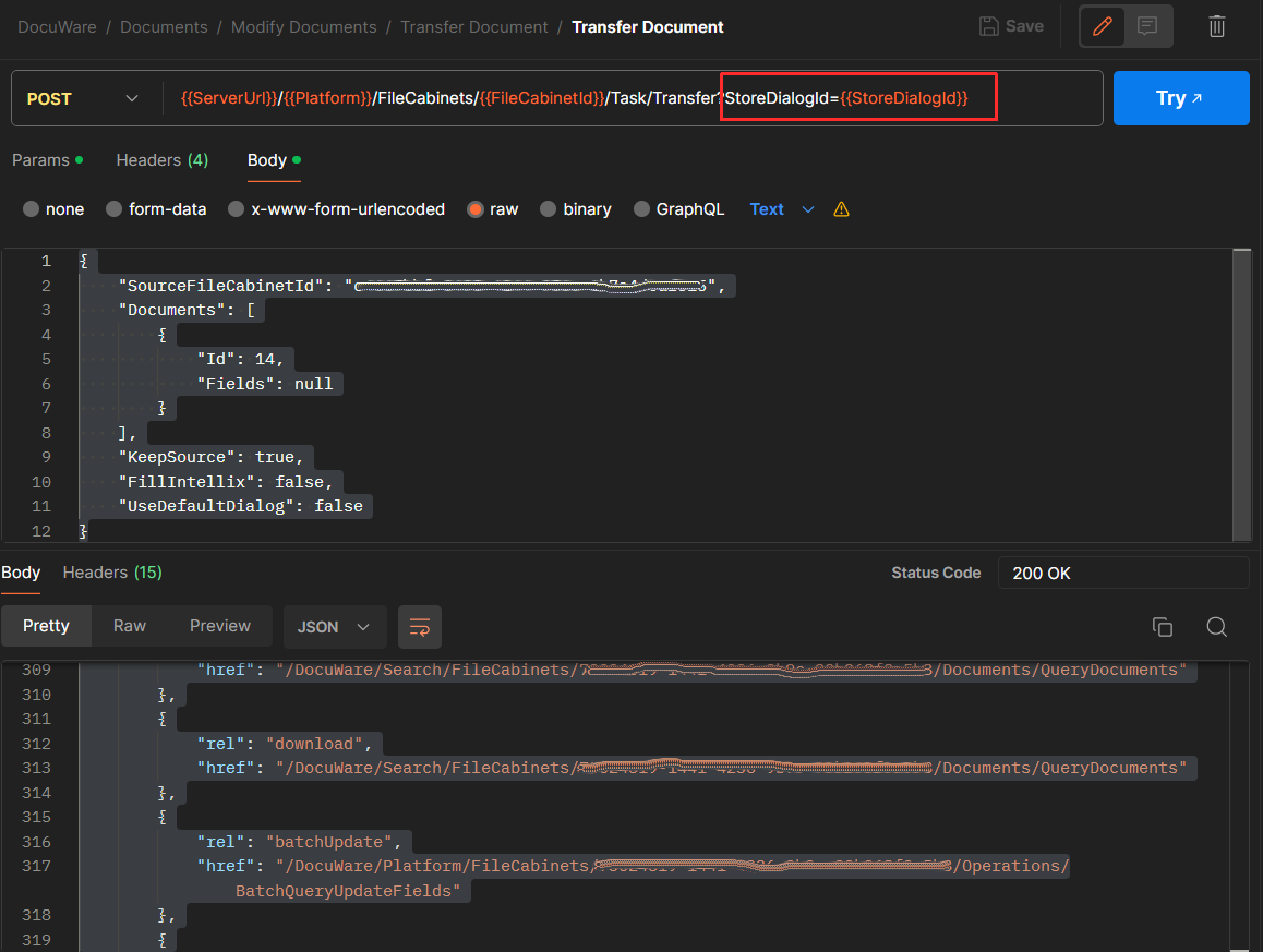

I am trying to transfer a document from 1 file cabinet to another file cabinet. This function works just fine using the postman examples, However using the DocuWare Platform API option in a workflow I see that the StoreDialog portion of the web route is missing.
Am I missing something here?
See attached screenshots for an example of each route, and notice the missing StoreDialog from the Workflow feature.

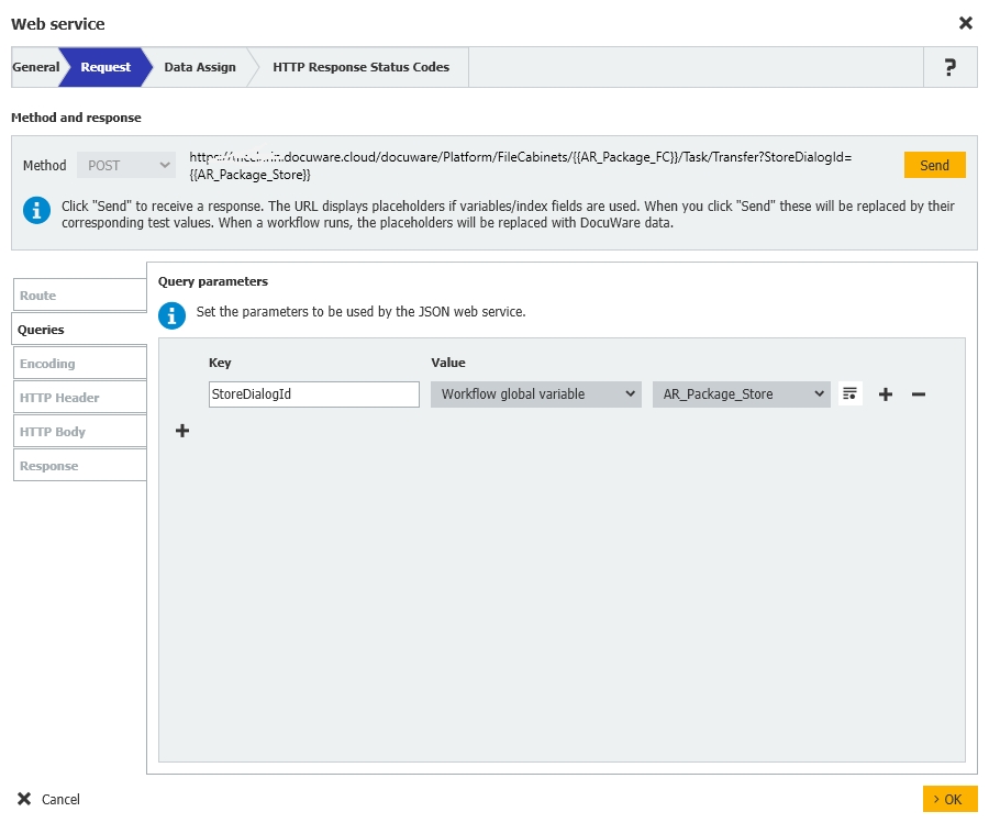

A colleague answered this question for me, The Request Tab has a Query option, and after typing the variable there I am also able to type in the Store Dialog ID in the variable.
Hope this helps someone else!
