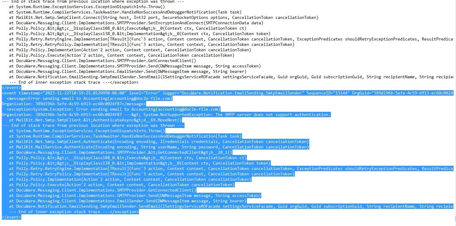

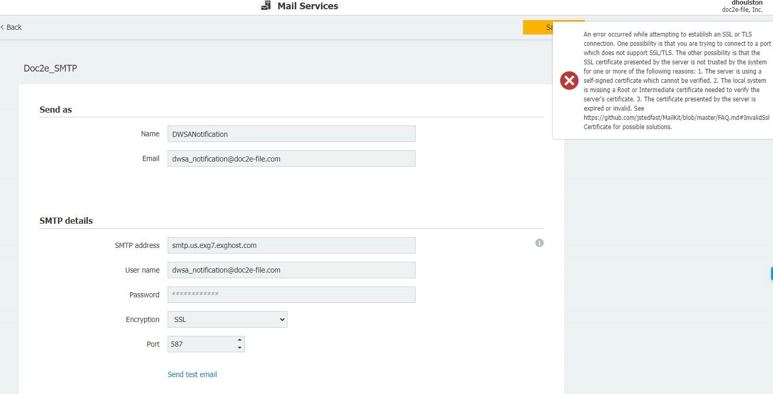

I've attached screen shots of 3 of the logs I've submitted over the last few months. There are many different errors based on the troubleshooting I've carried out.
It is an SMTP issue. It may well be something on our side or it could be something with our provider or it could be a unique circumstance with DocuWare itself. What we need is a DocuWare expert that can help diagnose and explain where the breakdown is occurring and offer options to resolve. I can look at the logs all day but I am not manufacturer of the product and I do not possess the skills or information to completely understand what it happening. I am 100% sure there is somebody at DocuWare that can look at this issue and understand where the problem lies and how to resolve it. I can provide any and all information about our systems and configuration.

Also, in your last screenshot, you are using SSL with Port 587, however, 587 is default for TLS/STARTTLS, SSL default is 443. This might be intended, or might be an oversight, depends on your SMTP Server.
This is definitely either an SMTP Server issue or a network issue. If you want to test SMTP without the DocuWare overhead, it uses the NuGet Package "MailKit" Version 2.3.1.6 to send e-mails.
