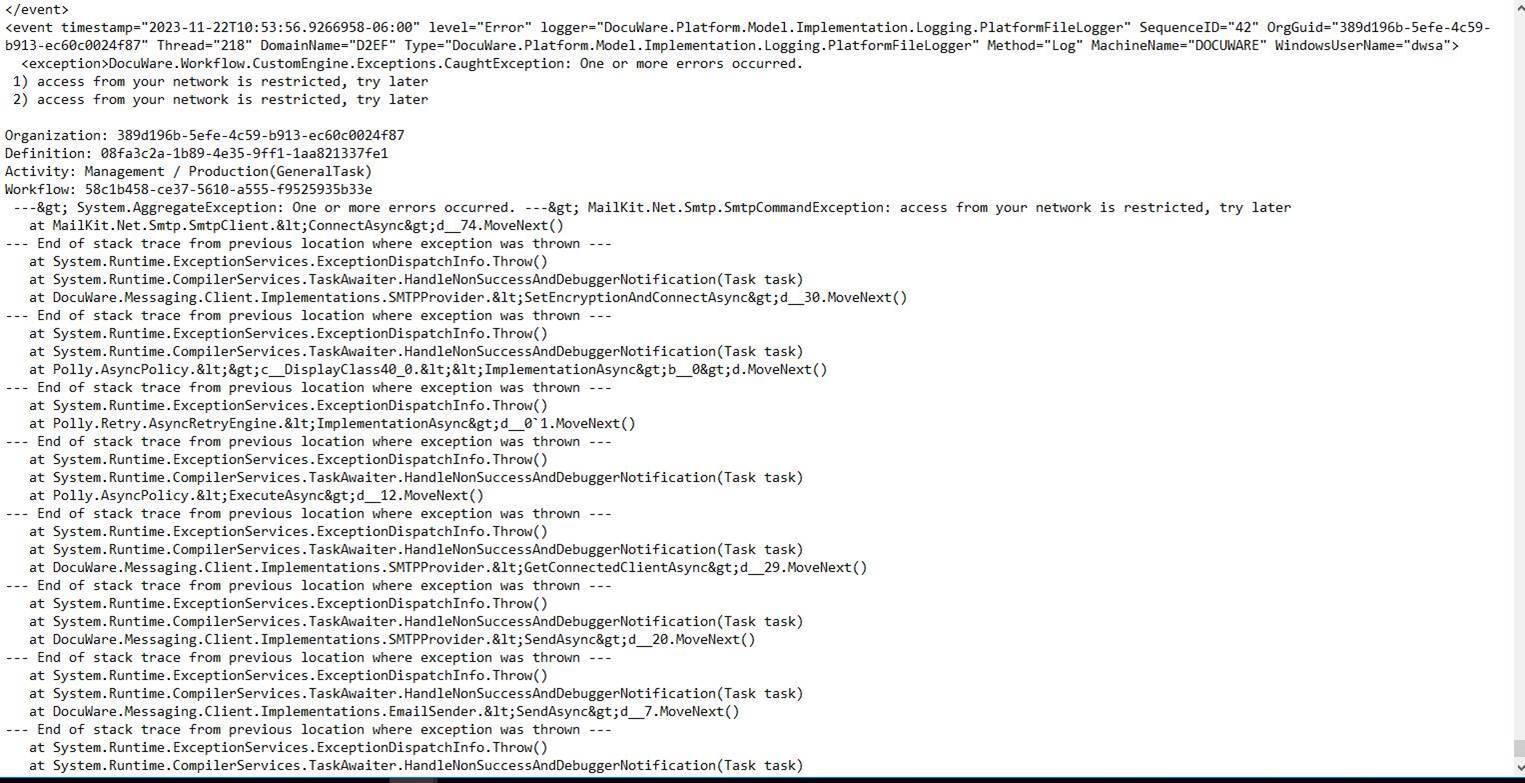

I've attached screen shots of 3 of the logs I've submitted over the last few months. There are many different errors based on the troubleshooting I've carried out.
It is an SMTP issue. It may well be something on our side or it could be something with our provider or it could be a unique circumstance with DocuWare itself. What we need is a DocuWare expert that can help diagnose and explain where the breakdown is occurring and offer options to resolve. I can look at the logs all day but I am not manufacturer of the product and I do not possess the skills or information to completely understand what it happening. I am 100% sure there is somebody at DocuWare that can look at this issue and understand where the problem lies and how to resolve it. I can provide any and all information about our systems and configuration.

to me, these messages sound like your SMTP Server does not allow your DocuWare System to log in. That could have several causes, which I cannot read from the logs you provided.
Maybe the SMTP Server itself or some firewall in between your DocuWare Server and SMTP Server block traffic from everywhere except some whitelisted IP Addresses, maybe the mail account(s) you are using is missing SMTP permissons. It might even be an SSL problem regarding an expired certificate or one with an old, unsupported encryption type.
Also, in your last screenshot, you are using SSL with Port 587, however, 587 is default for TLS/STARTTLS, SSL default is 443. This might be intended, or might be an oversight, depends on your SMTP Server.
This is definitely either an SMTP Server issue or a network issue. If you want to test SMTP without the DocuWare overhead, it uses the NuGet Package "MailKit" Version 2.3.1.6 to send e-mails.

Sorry, after taking another look, it is obvious that the SMTP Server is not on your network, but connected to via internet.
Have you already tried using tools like the Microsoft Connectivity Analyzer or mxtoolbox to check for connection issues?

Microsoft Connectivity Analyzer passes all tests.
mxtoolbox looks OK also but I don't have the purchased edition to dig deeper.
