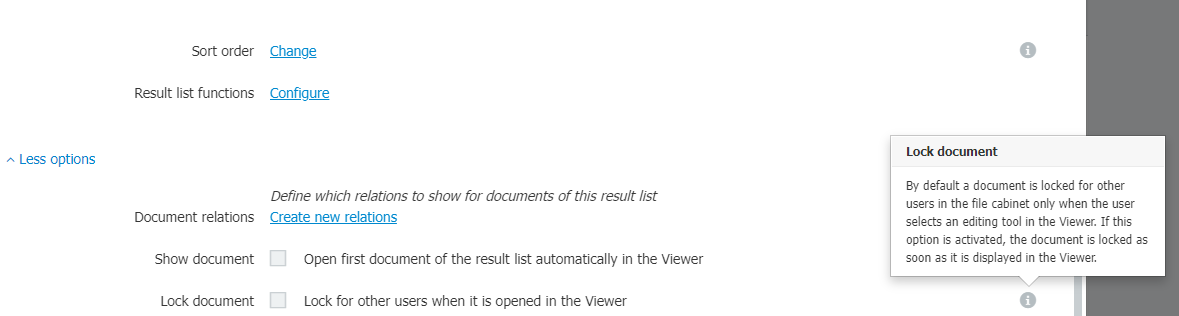

Open up the web configuration, navigate to file cabinets, open the file cabinet of your task, navigate to dialogs and here to the result list which is set in the workflow designer of the respective workflow, scroll to the bottom, click on More options, disable/uncheck the option "Show document - Open first document of the result list automatically".

Posted Mon, 14 Aug 2023 13:29:24 GMT by Masudi Musonda Solution specialist
Hi Frank,
Mine is disabled by default.

Posted Mon, 14 Aug 2023 13:38:36 GMT by Frank Meyer Docuplan GmbH & Co. KG | IT-Leiter
Hi Masudi,
thank you for updating your previous answer, which I've done with this answer as well, to avoid any irritation.
If the first option is already disabled, which is, as far as I know, not the default setting, I don't have any other ideas in this topic unfortunately.
