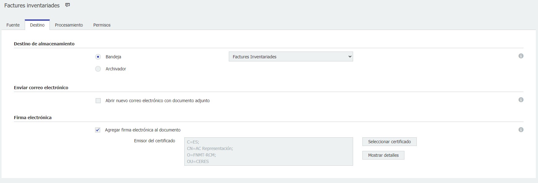

I've got a question related to our customer stored invoices. I'm setting up his digital signature certificated, but I don't know how to check if it's working right...
- On picture attached, can you tell me if I'm setting up right? (I don't know if I must to store into a file cabinet or into a tray...)
- Then, where can I find those signed invoices? How can I check if there are signed?

this way you attach an electronic signature to all imported/scanned documents.
The signed invoices will appear in the document tray which is selected above.
To check the signature, you have to download the PDF and open it in Adobe Acrobat Reader. There you can see and check the signature.

Great Tobias, it's solved!
