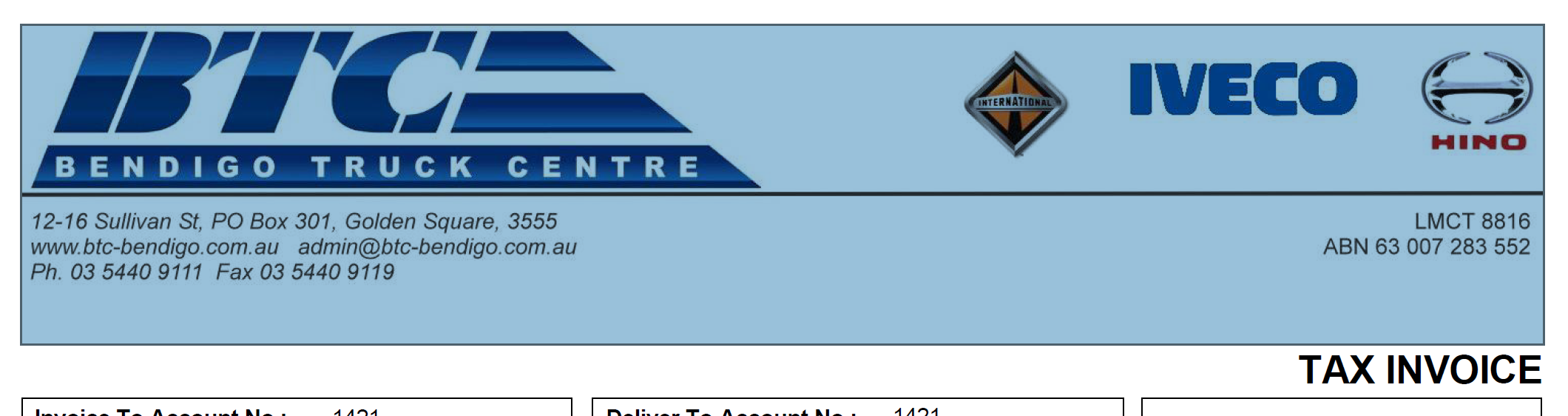

We have an customer that is already using DocuWare but it is not happy with the manual work required once the tray OCR result don't bring supplier name and ABN(Australia Business Number) from document header.
I was checking the PDF on adobe reader and looks like the header of the PDF is a image and the rest of the document is a normal PDF structure.
After some tests we figure out that converting the PDF to JPEG before importing to tray, improved the OCR result bringing the supplier name and the ABN.
So we are thinking to provide an solution that is going to convert the PDFs to JPEGs before importing into the tray.
This issue is only happening for just some suppliers documents. But they receive a lot of documents from these suppliers.

Screenshot 2020-11-23 182731.png (472.3 KB)
