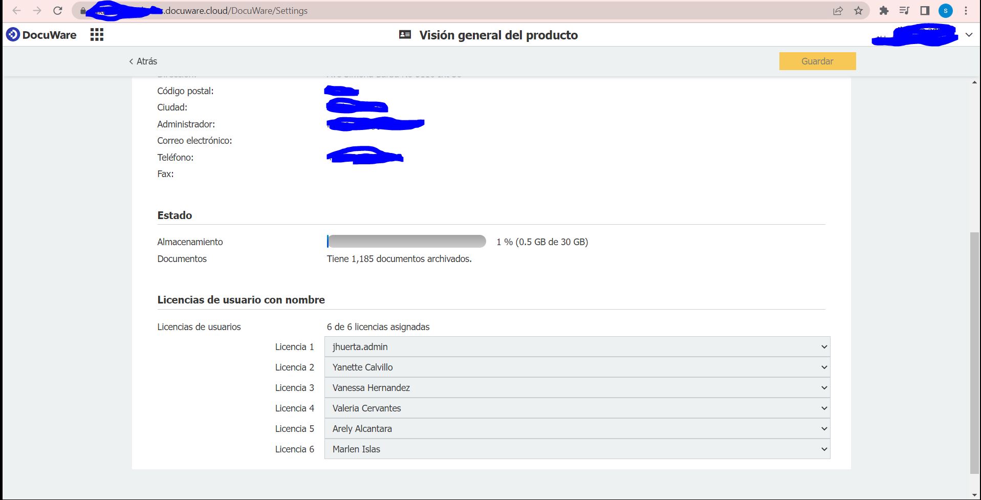

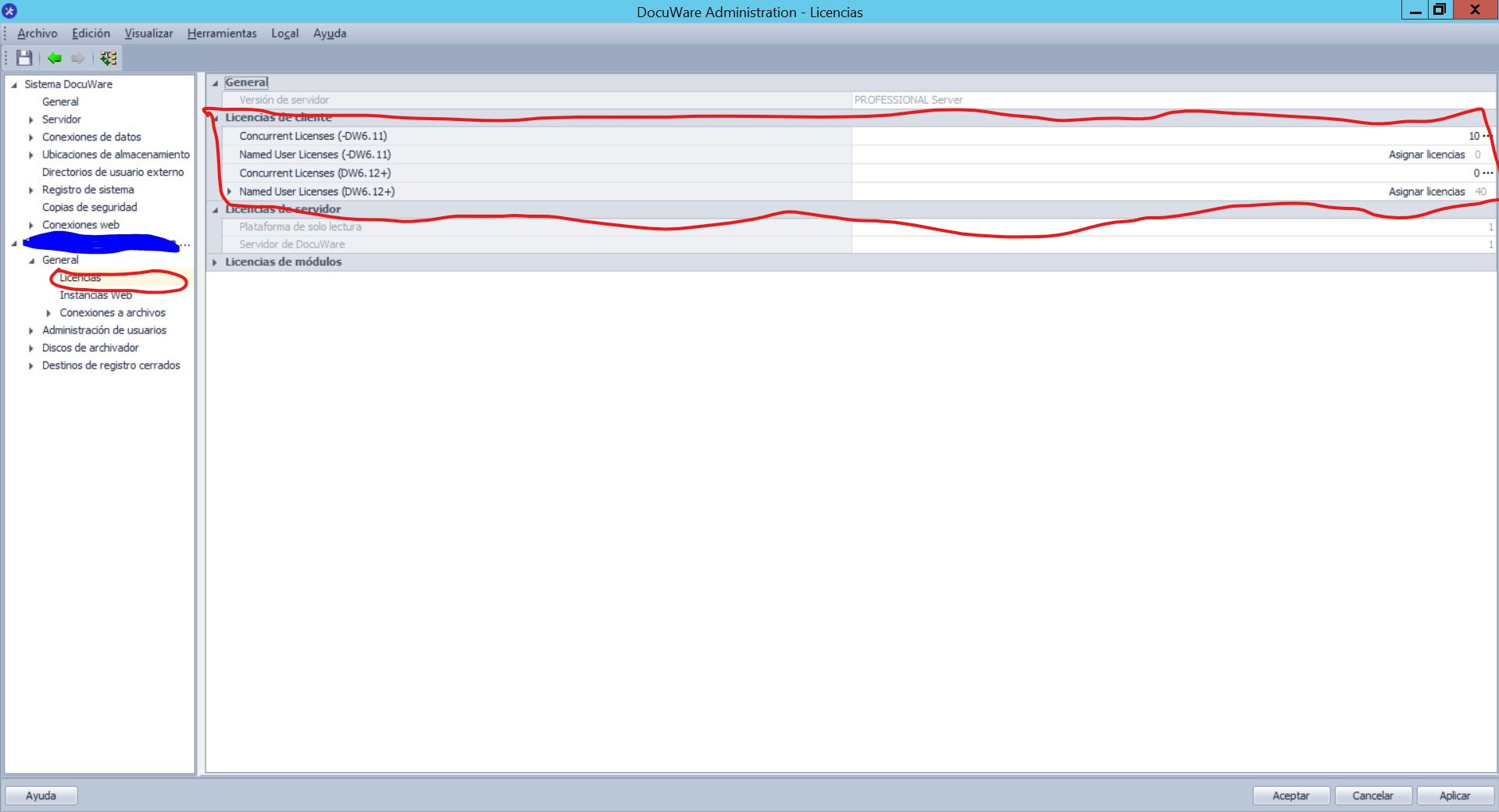

Where can I see how many DocuWare user licenses I have in total, used and unused? I also want to know where do you see the storage capacity occupied by docuware? System weight and customer documents?.
Posted Thu, 28 Apr 2022 18:54:39 GMT by Lucia Barron Programador
In docuware cloud, logging in the browser with the docuware administrator user,<br> configuration / product overview&nbsp;&nbsp;for both occupied space and licenses<br> <br> In docuware on premise in the administration to see the licenses you must go to part of (name of the organization) / general / licenses<br> <br> Finally, if you want to know how much space the documents occupy, you must go to administration / storage locations and from there see the url of the paths, you must go to those locations and through the windows properties see how much space they occupy.<br> <br> in file cabinets is where the documents are stored.<br> <br> &nbsp;
