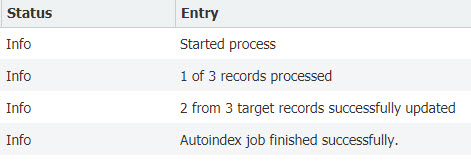

I tested this again in DocuWare 7.3, and it doesn't look like it's any more helpful - at least not with default logging.  I configured an AIX job that updates a file cabinet date field from a file connection.  After configuring the file connection appropriately, I went back and fudged some of the date entries so they weren't acceptable date formats.  The AIX job just skipped these without any meaningful mention as to which ones or why (see screenshot).
The AIX log isn't very helpful either: "Multiple file parse errors"
