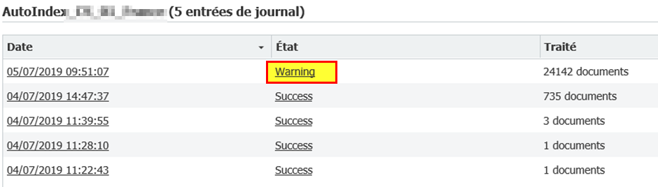

Got some Warnings in Auto Index job report.
Does someone know where to find additional logs events for Auto Index ?
We have some indexing warning but we cannot find the faulty records to investigate data source.

Publicado Fri, 19 Jul 2019 10:22:05 GMT por Christophe Mathieu Ricoh Luxembourg PSF sàrl Document Solutions Specialist
Unfortunally, logs in %PROGRAMDATA%\DocuWare\Logs\AutoIndex only show errors on BPS process level. There is no information about Warnings on Auto Indexed documents.
What I need is details about theses Warnings (wich document, why there was a warning ...)
Publicado Thu, 13 Aug 2020 01:20:03 GMT por Matthew Trembly Software Support Manager
I tested this again in DocuWare 7.3, and it doesn't look like it's any more helpful - at least not with default logging.  I configured an AIX job that updates a file cabinet date field from a file connection.  After configuring the file connection appropriately, I went back and fudged some of the date entries so they weren't acceptable date formats.  The AIX job just skipped these without any meaningful mention as to which ones or why (see screenshot).
The AIX log isn't very helpful either: "Multiple file parse errors"
