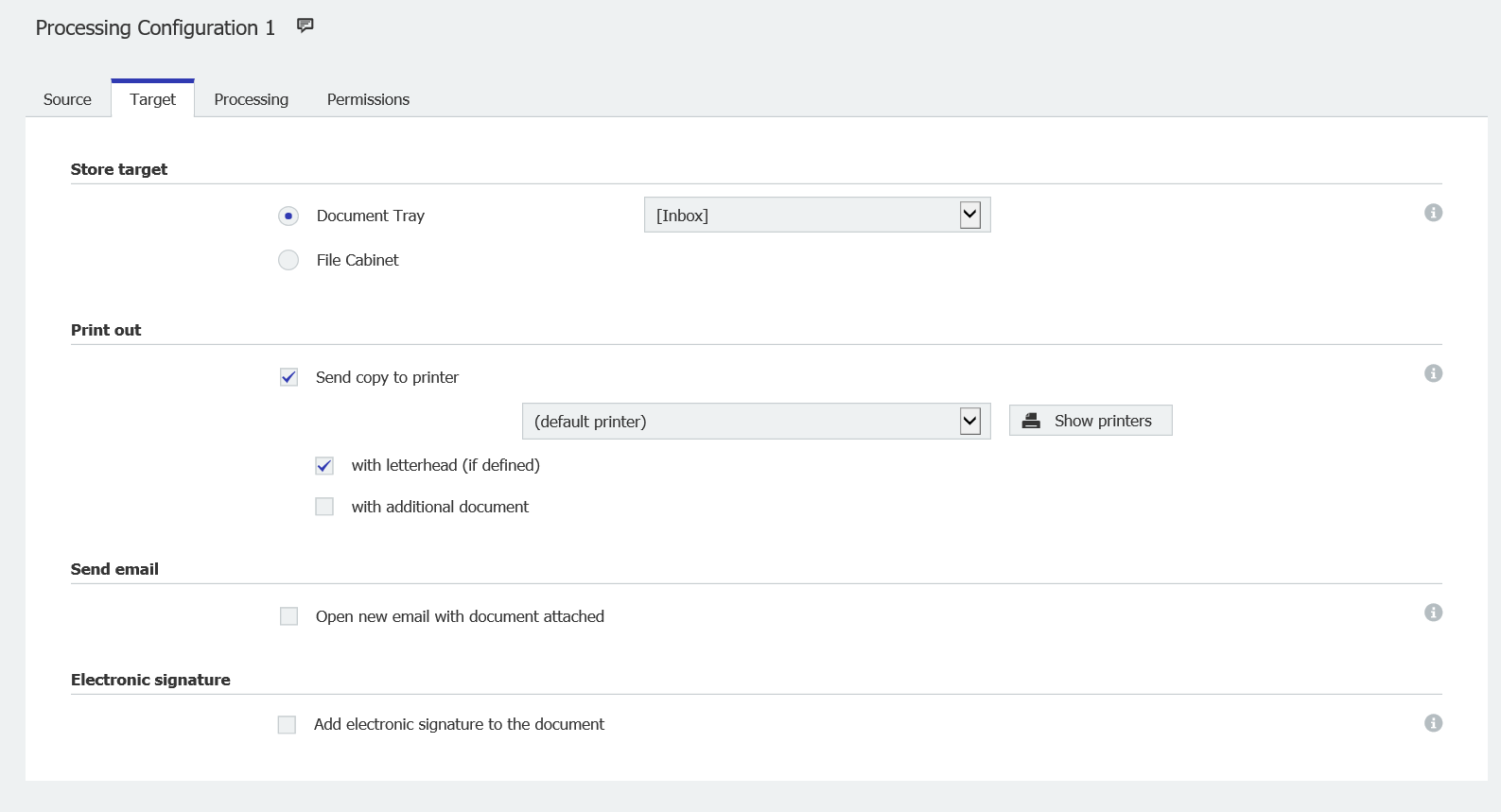

How do you set up the configuration to the physical printer in the office?
More specifically, if I use the DocuWare printer, I want my documents to be printed in the office aswell.

Posted Tue, 22 Oct 2019 08:02:56 GMT by Patrick Kollar Software Support Specialist Team BLUE EMEA
Dear Mrs. Verjans,
this option is available in the "Target"-Section in the DocuWare Printer configuration.
Just tick the "Send copy to printer" tickbox, then you should be able to choose the hardware Printer you want to use.
I also attached a screenshot for a better understanding.
Thank you.
