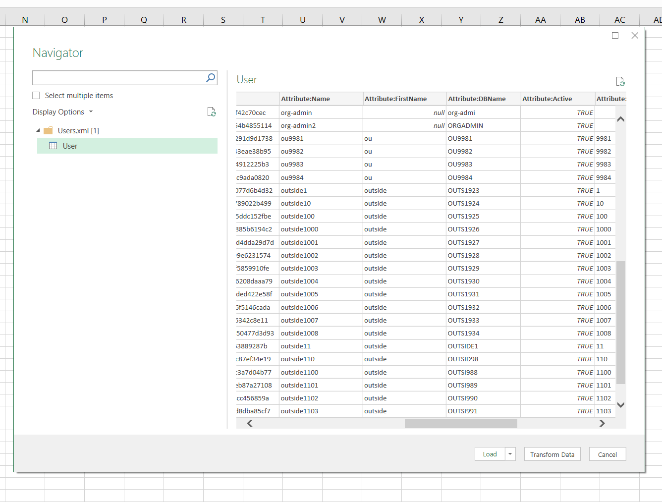

Posted Thu, 23 Jan 2020 15:41:48 GMT by Gerardo Lisanti Manager Product
Hi Keith,
you can try to get the users via the REST API and import them into e.g. Microsoft Office Excel
  • Login to DocuWare as Administrator
  • In a new tab open https:// ... /DocuWare/Platform/Organization/Users
  • Right click and Save as XML file
  • In Microsoft Office Excel import the XML file via Data > Get Data > From File > From XML
    see screenshot attached
Let me know if this helps.
