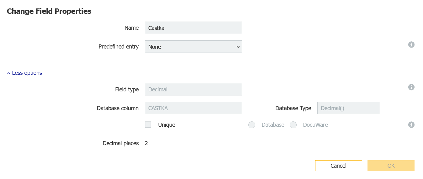

I am trying to import some values via Desktop App / Import feature via dwcontrol file.
I am unable to import database field type decimal. There are several examples for db field types - text, date, numeric, etc., but no one for type decimal.
I tested it in this format:
<Field dbname="Castka" type="Decimal" value="64544,56" culture="cs-CZ" decimalPlaces="2" />
Even if Import is successful, field "Castka" in Docuware stays empty (without data, means @IsNull = "true").
Value is number with 2 decimal places (en-US format of this number is probably 64544.56).
Can you hint me what is correct format or if is possible to Import Decimal type of database field at all?

Hi Simon,
you are correct that "Castka" is FieldLabel and not FieldName which is "CASTKA".
