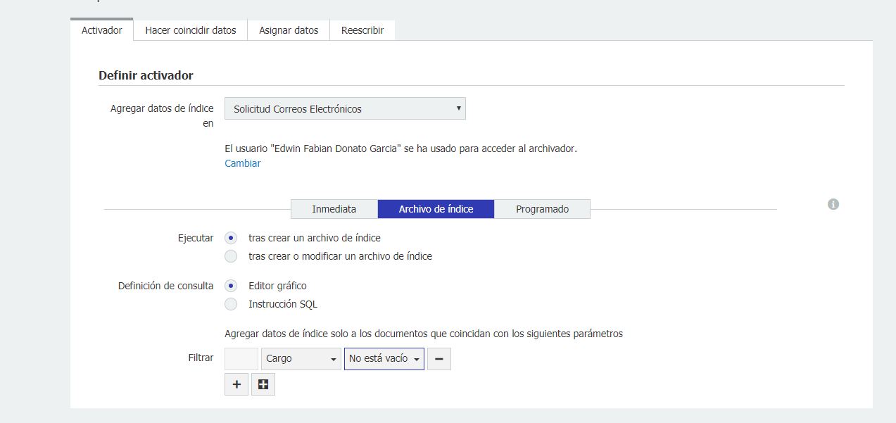

From which autoindex option can I consult the fields of a form's drop-down list?
I can not find the option
Registrato Tue, 26 Mar 2019 16:39:23 GMT di Josef Zayats
Carlos,
let's say your form dropdown list for field ShipmentType has 5 choices :
MethodA,
MethodB
MethodE
You create 5 similar AutoIndex jobs,
criteria for 1st is ShipmentType = MethodA,
criteria for 2nd is ShipmetType = MethodB
etc.
and each job writes whatever data you need into corresponding Index field
