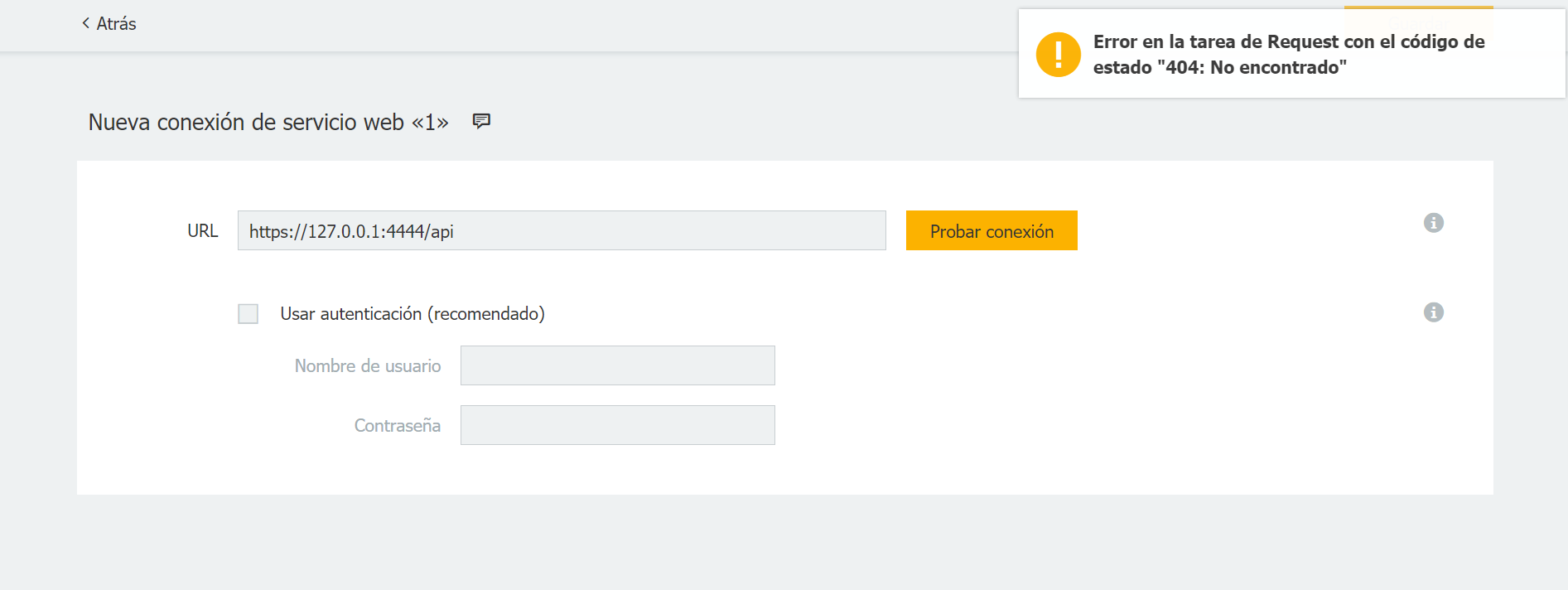

I have been trying for several hours to get the DocuWare Rest service.
I have already installed node.js and ran the server.js getting the message "{" Status ":" OK "," Reason ":" Validation web service is up and running "}" now, I am trying to connect from a service cloud to https://127.0.0.1:4444/api but it always gives me the error "Request task failed with status code" 404: Not found "I feel that the documentation is missing something that I don't know can be.

I think you are messing two things up here.
The configuration screenshots you sent are for webservice configuration. You need that one when you want to use a webservice (programmed by you) as a workflow step in workflow designer.
The REST API is available via the platform service ( http://docuwareServer/docuware/platform ). You do not need to set a specific configuration or anything, platform service is always available.
Did you already have a look at the developer documentation? Documentation
