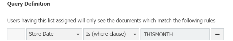

try to use the "is (where clause)" condition with "THISMONTH".

投稿済み Thu, 01 Dec 2022 22:50:32 GMT 、投稿者 Jason Scott
Hi Gerardo,
UPDATE: This actually does work on 7.7. Thanks for this
Below is what I get on 7.6 which is where i was testing this.
Wrong condition! Field : DWSTOREDATETIME Value : THISMONTH
