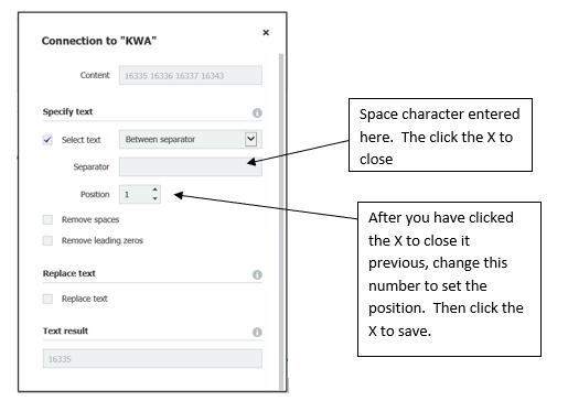

Veröffentlicht Thu, 04 Apr 2019 14:11:05 GMT von Craig Heintz SE
I have answered my own question.
