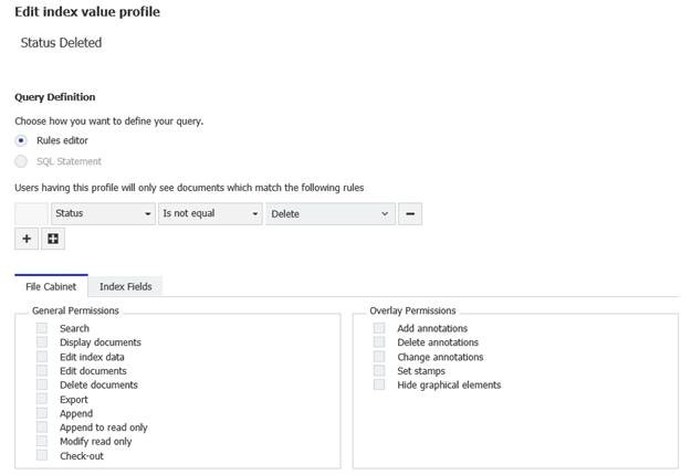

Veröffentlicht Mon, 31 Aug 2020 19:12:29 GMT von Michael Weingand Professional Services Manager
Hi Folks,
  1. tried setting this up and it still shows all documents including the ones with a Status=Delete.
Here is a screen shot. I assigned this to my test user. Is there anything else I need to do?
Veröffentlicht Tue, 01 Sep 2020 06:33:42 GMT von Maria Merkel DocuWare Europe GmbH Technician Software Support Team RED EMEA
Hi Michael,
permissions in DocuWare are additive. This means that one profile cannot remove permissions granted by another profile.
First, add the permissions the user requires to the index value profile. Then remove any other profiles that give the user permissions to the documents.
