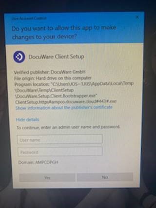

A user trying to update the desktop apps using a 7.5 cloud system has been prompted for an admin user name and password. Is not this a thing of the past? I thought the desktop updates no longer required elevated permissions. See screen shot uploaded.

in my understanding, the change works like this:
You need administrative permissions to upgrade from any older Version to 7.5, just like it used to be.
Administrative privileges are not needed when upgrading from 7.5 to a newer 7.5 with hotfixes or (probably) 7.6.
