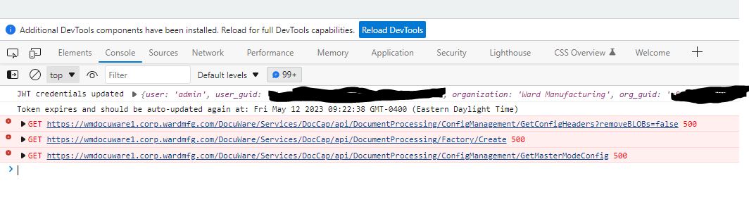

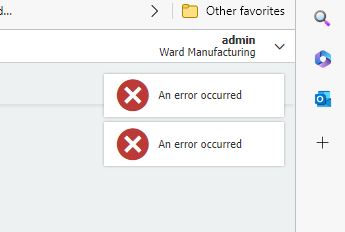

The thread titles says it all.  It is just Document Processing.  Everything else is working.  Attached are the very helpful errors that pop up on the screen and Edge's dev screen.<br> <br> Server side on DocuWare.DocCap.log I find this.  Authentication failed with HTTP response 500 and ApiFaultCode 'Unknown'.......  Well, Edge told me that.  Digging further I find this.<br> <event timestamp="2023-05-11T11:55:21.6136834-04:00" level="Warn" logger="DocuWare.Web.DocProcBase.Controllers.Util.SettingsServiceAuthenticationAttribute" SequenceID="32" Thread="87" DomainName="XXXXXXX" WindowsUserName="XXXXXXXX"><message>Session for SettingsService 'https://XXXXXXXXXXXXXXXXXXXFQDN/DocuWare/Settings/SettingsService.svc' could not be validated due to unexpected error</message><exception>System.ServiceModel.Security.SecurityNegotiationException: Could not establish trust relationship for the SSL/TLS secure channel with authority 'XXXXXXXXX'. ---&gt; System.Net.WebException: The underlying connection was closed: Could not establish trust relationship for the SSL/TLS secure channel. ---&gt; System.Security.Authentication.AuthenticationException: <em><strong>The remote certificate is invalid according to the validation procedure.</strong></em><br> <br> The certificate is working for ever other part of Docuware so how can this be the certificate?  Has anyone come across this?  There was a prior thread that was close to my problem, that did not go into much detail.
