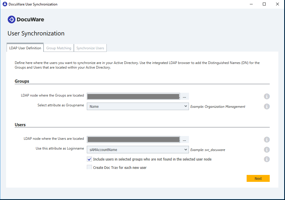

Posted Mon, 25 Mar 2019 14:37:13 GMT by Craig Heintz SE
My experience with the latest patched version 7 is that for on premise LDAP sync, no trays are added.  For User Sync to cloud, there is now a check box to determine if a Tray should be added for each user or not.  I included a screen shot of the Cloud User Sync Tool.
