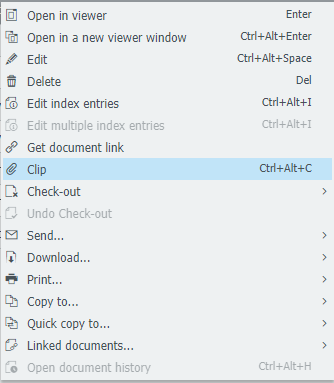

When using the web client, you can clip documents to an existing document by right-clicking on the document and selecting the "Clip" option (as depicted in the first attached image).

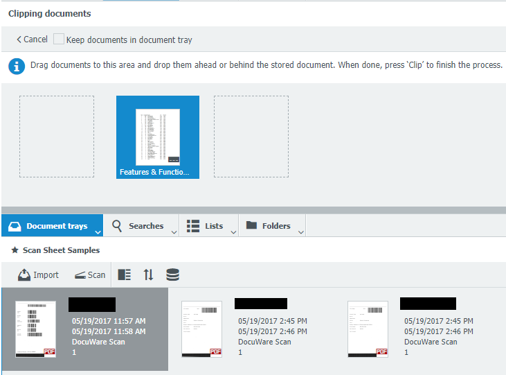

After selecting that option, the Clipping operation is made available via a two-pane screen with the starting document on the top and places to pull in other documents (to clip) on the bottom (e.g. a Document Tray). The second attached image depicts this interface.
So far, so good. You can drag documents to clip in front or behind the starting document, then click the yellow "Clip" button to clip everything together in the order you have assembled. It's really quite nice. The starting document retains all of its indexes, and the clipped document is tacked on back (or front). In my testing, it doesn't even change the Document ID of the starting document. Plus, you can ask to preserve clipped documents in their source tray instead of deleting them.
