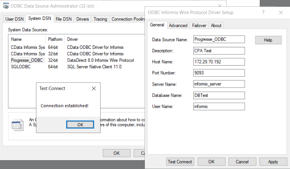

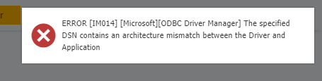

One of our customer is using Delta Bank as its Core Banking system, based on an Informix Database. When we try to use this database with AutoIndex, dropdown lists or WF, we get an error.

thank you for the screenshots with details.

However, the error message from your screenshot clearly shows the problem: architecture mismatch.
The ODBC data source you configured is 32-bit, but modern DocuWare Versions always expect 64-Bit.
Please delete your ODBC data source and create a new one using a 64-Bit ODBC driver, then the issue should be resolved.

Nevertheless, when we create an ODBC 64bits connection, we can't see it from DocuWare Administration (in my understanding, first we need to setup the ODBC, then add it to Docuware admin and finally use it with DocuWare Configuration for auto-Index purposes for example).
Is there something I miss ?
