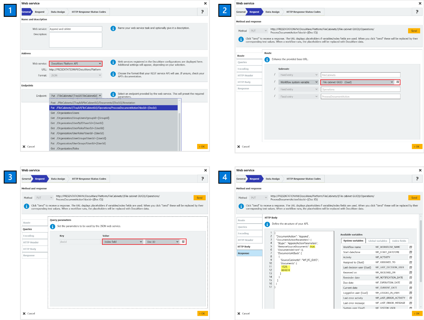

The configuration looks like this:
  • Create a workflow and define appropriate trigger conditions
  • Add a new web service activity
  • On tab "General"
    • select web service "DocuWare Platform API"
    • select endpoint PUT  /FileCabinets/{TrayId/FileCabinetId}/ Operations/ProcessDocumentAction?docId={DocId}

I've attached a screenshot of a sample configuration.
